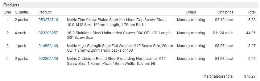

#97 · (Edited)
here is my product list from mcmaster-carr for the shock install.
the spacers will be drilled out to 12mm, and i got the 10mm washers because the 12mm washers were actually 13.something ID. im just going to drill the 10mm out to 12mm for a precise fit plus the OD of the 10mm washer is more inline with what im doing.
then drill the upper and lower mounting holes of the shock itself to 12mm and open the clevis up a little bit with a file.
oh, and trim down the plastic flap. bought a 10 dollar dremel for that at harbor freight, but im going to wait and get a precise measurement.
