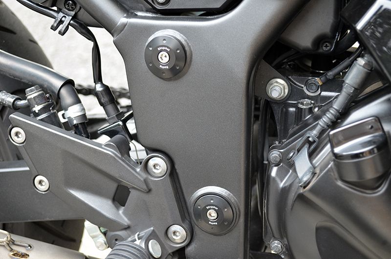

Seen these pop up on eBay early this week.. Has some money in my eBay points account so why not, you all know me and my mods..
Personally I would not of paid $55 total for them, only becacause I wanted black, and it wont look much different than stock, but total cost to me was less the $15 after my eBay points :D
http://www.ebay.com/itm/230909590029
These are the manufactures pics, I didnt take my own as my bike is torn to bits at the moment:
Now I got the black ones like shown above.. I think its a nice little mod, just for a little different look.. There is alot of machine work to these little things so the $55 price tag is worth it for what your getting, but unless you want to pay $55 for a color, it would not be worth it.. I personally thing the price should be in the $30-$35 range only becuase the item itself is so small, but that is just me..

I got the SSR frame plugs and they come in 2 different sizes. I put the longer plugs with the O-rings in the upper frame hole (they won't fit in the bottom because they hit the bolt). So then I try to install the lower plugs and they are too small and don't get tight. Anyone else have this problem? No instructions included, but it should be a 2 second job. On the outside of the bubble package it has a sticker that says FP250R. I'm thinking that I ordered the 300 plugs and got the ninja 250 plugs by mistake?? Does anyone know if they are the same size for the 250 and 300?

Yup you got the same ones as I did. They do fit. Mine also said 250 but will fit our bikes. The one with the rubber o ring goes on top and the other one on bottom. I did have trouble with the bottom though. You need to tighten the bolt while holding it in your hand untill the spreader spacer gets pushed out almost to the size ofnthe frame hole. Then you need use a inch pound impact gun to tighten it up. Doing it by hand while its in the frame will just keep spinning. If you need more info I can make a quick video just let me know.....
