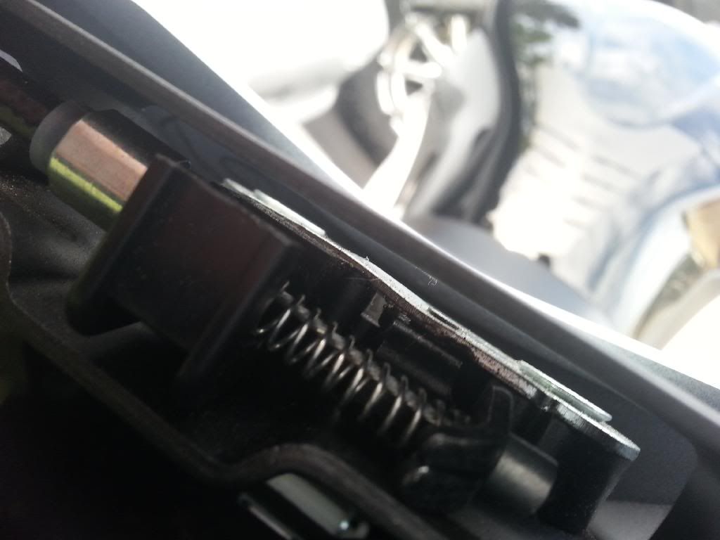

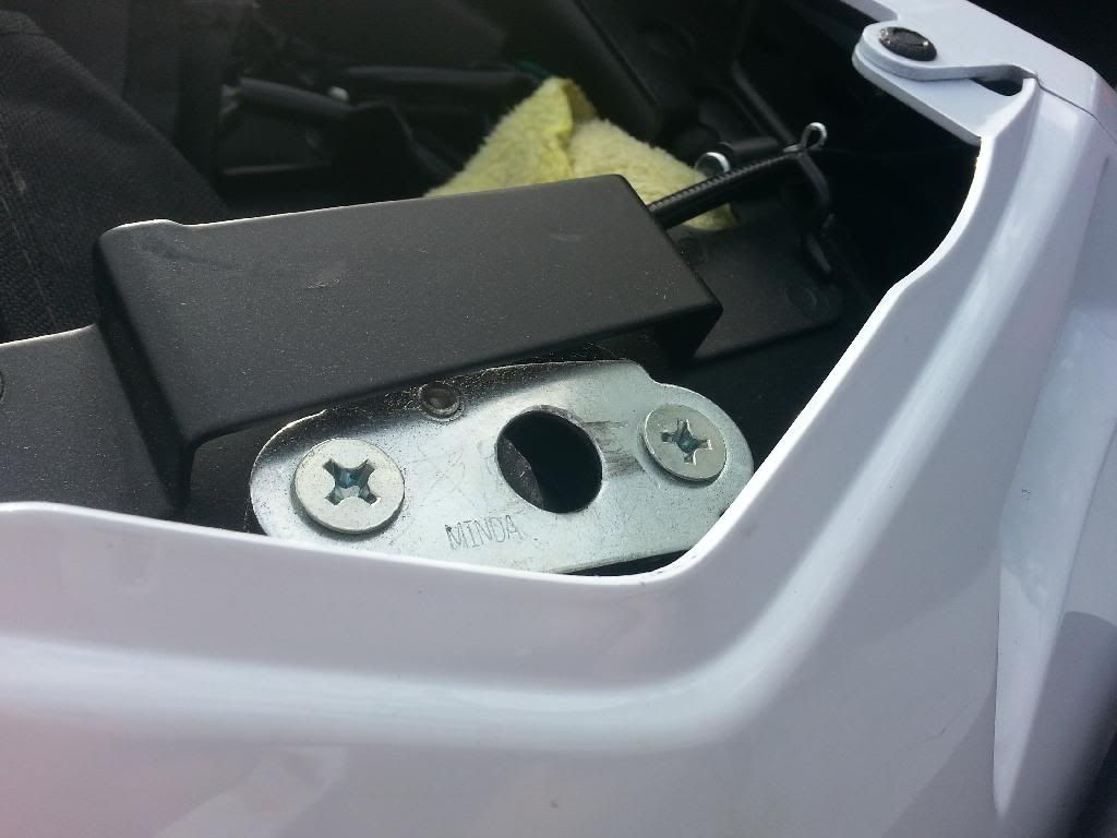

I noticed that my rear seat really wobbles even when locked and closed. I read that this can happen on bikes when someone bends the plate on the top of the lock, mine looks bent but that also seems to be how it comes from the factory. it seems to have somewhat of a s shape but looks flush to where it mounts. I don't remember if it did or did not wobble before. I tried to get some pictures of it and a video

this is not right
i just went a look at mine, mine if straight as an arrow, the top of your lock is bent & twisted
Cool thanks, ya the wobble is horrible. I think someone must have tried to pull it open at some point

The second picture it looks like maybe someone tried to pull the seat up or off the bike.

Any one have any idea how study that part of the bike is? I'm wondering in I can just tale a hammer and my socket extension and whack it back into place?

my rear seat has a little bit of movement, say no more then 2-3 millimetres.but if you look at the design of it, its pretty simple.
the rear of the seat locks in via 2 pins and the front held in with the 1 lock pin.it would seem the front lock pin needs to be pushed lower towards the rear tyre.
by doing this, it will drop the front of the seat eventually to a point where it will sit flush with the fairing and hardly move at all like mine does.
next question
is the bike under warranty??? if so take it back to the dealer
if not find some way to press the front metal bar the lock mech bolts to downwards towards the tyre

Bike is still very much under warrenty, I'll drop by the dealer and see what they can do for me. I'm thinking it will take some grinding down of the 2 posts that the lock plate screws too. In my picture the one on the left is higher than the one on the right and the plate looks like it sits flush on both pedestals but I can clearly see the s shape that's bent into it

The sides of the seat rests on two pads, the locking pin has no way of pulling the seat down it just locks on the cut out of the pin. Tolerances mean there is a gap between the seat and the two pads. I got some sticky foam pads; I think they are to prevent furniture from scratching the floor or something. They are about 4 mm thick. Cut them to fit and attached to the seat. No play at all, I have to push lightly on the seat to get it to lock and the same to get it to open.
