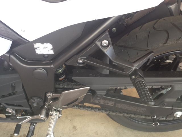

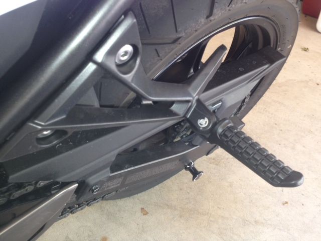

Been getting a lot of people asking me what I used and how I got my stock exhaust heat shields flat black. I scuff it up with a red 3M scuff pad, cleaned it up with wax and grease remover and applied 5 wet coats of Plasti-Dip.
This is the end result:
If you've done any Plast-Dip work on your bike; post it up.
