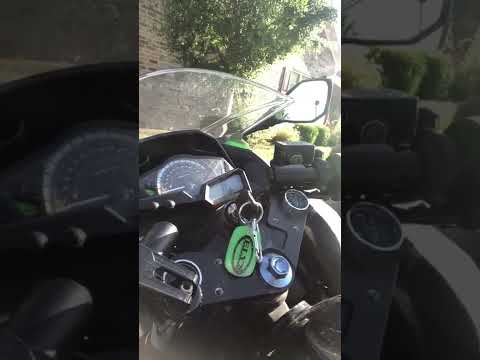

This is it trying to start until I hit it with starter fluid.

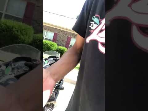

I rode it a couple miles and it demands to be high in the rpm’s or it will try to stall. Now it’s doing this at idle.
From the last video it looks like an air leak past the throttle bodies... You can spray LIGHTLY some carb cleaner around them (intake boot) and see if the IDLE rpm increase more.
If leak is found and fixed you gotta check the vacuum level according to the service manual.
