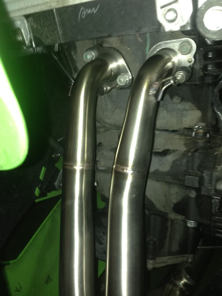

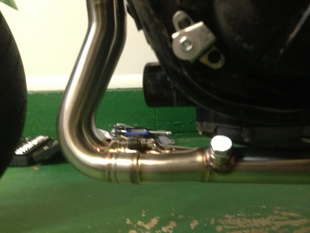

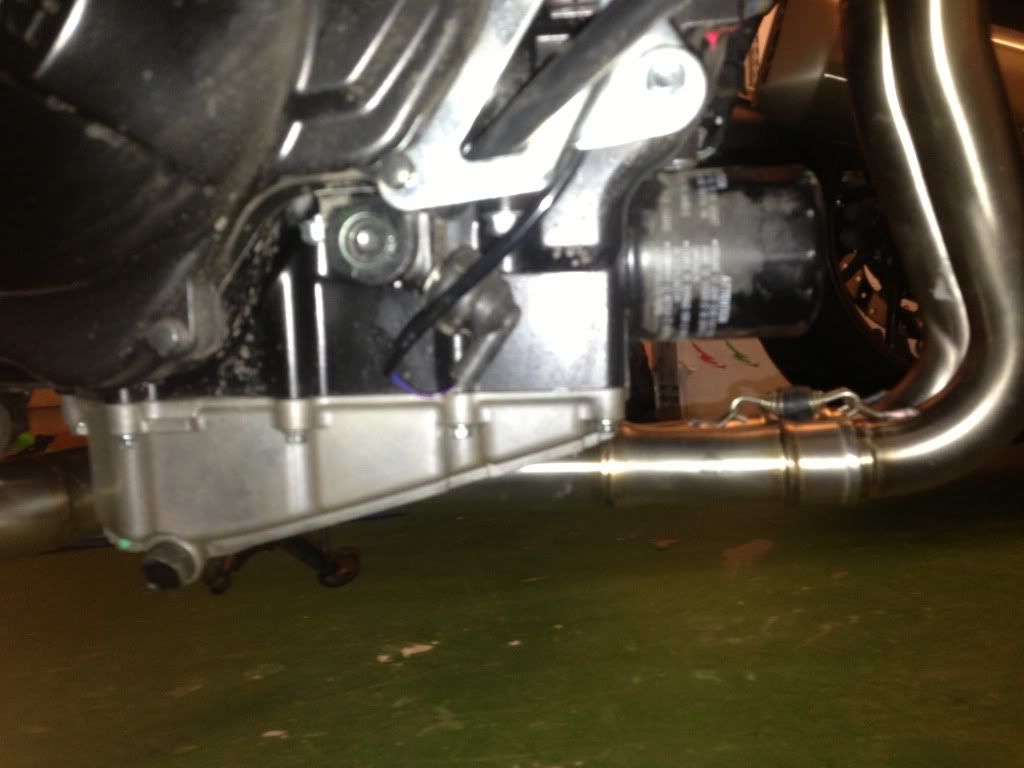

Watch a few YouTube videos on installing the Leo Vince full exhaust for help and glad I did. The exhaust comes in 5 separate pipes, including the muffler. I installed the new header flanges from Leo Vince, reusing the factory nuts and copper exhaust gaskets. Just remember the torque on the nuts is very low like 12-15 foot lbs; any more than that and you can damage the flange bolts and/or port openings. Just snug enough to hold the new connectors in place. First I tried installing the header pipes as seen on the videos, but that didn't work for me. The header collector pipe (3rd pipe down from the head) wouldn't line up to receive the header pipes coming off the head. So, I undid the two header pipes from the head and slid the collector pipe onto the two header pipes first before connecting to the head. I think the reason why this works better is because the exhaust routes differently with the Leo Vince full system. The factory pipe stays on the right side of the bike and back while the Leo Vince system curves onto the left side immediately then curves back to the right side. It stays tucked under the bike better and close to the oil drain pan.

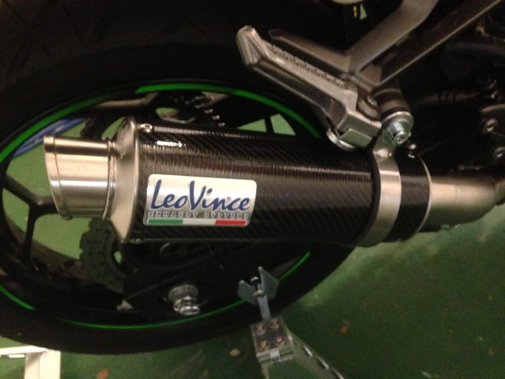

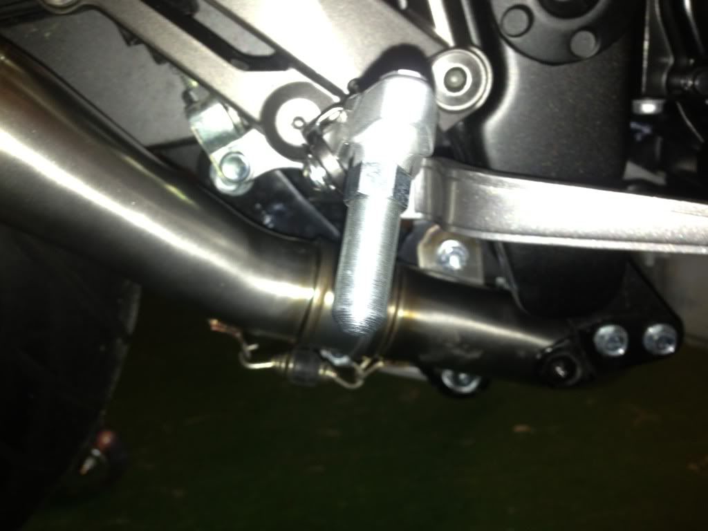

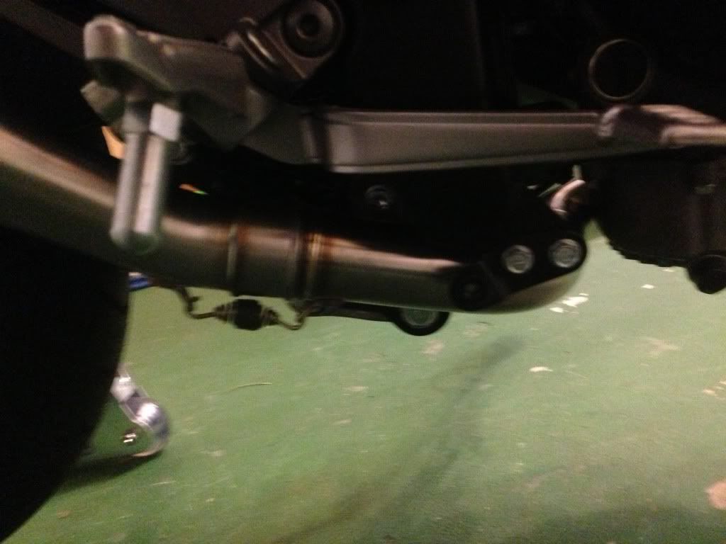

I attached the springs to the header pipes and to the collector pipe at this point. Inserted the replacement mid-mount bolt (shorter) and left it loose on purpose; just enough to keep the pipe in the right place. The 4th pipe inserted into the 3rd without any real effort, slipped right in ;). Attached the spring to this pipe and the 3rd pipe. Last pipe was the muffler itself, at first I thought it was too small. You must get the angle perfectly squared when inserting muffler pipe over the 4th pipe opening. There is nearly zero tolerance and might take a little effort and time to get them married up. Last bit was to install the muffler hanger around the muffler, and attach supplied bolt and rear spacer to the passenger peg bottom opening the stock exhaust used. Once I check everything was in proper place, I tighten down all the bolts and wiped the pipes clean.
