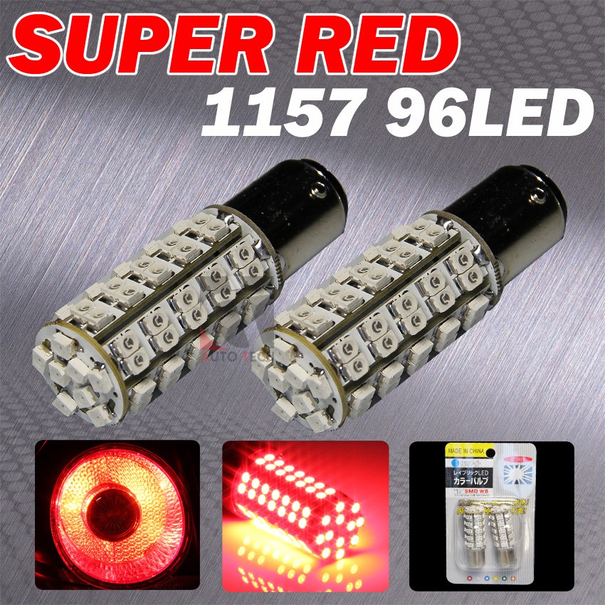

Rear Brake Light
http://www.ebay.com/itm/330701379931
I searched for a 1157 bulb, I would say these are WAY brighter than stock at least at night, in the day if the sun hits the tail light just right I would says it is about 75% of what the stock bulb was.
They are expensive and only come in a two pack you but can sell the extra one on here to another member. I have a friend who also bought a 300 so we just split the cost of it.
I bought this one because it was the one with the most LEDS I could find, the only possible brighter one on eBay at the time would of been the CREE LED.. IF anyone knows about CREE LEDS they run HOT, and can burn out if the are in a location that stays on, such as a running light.
