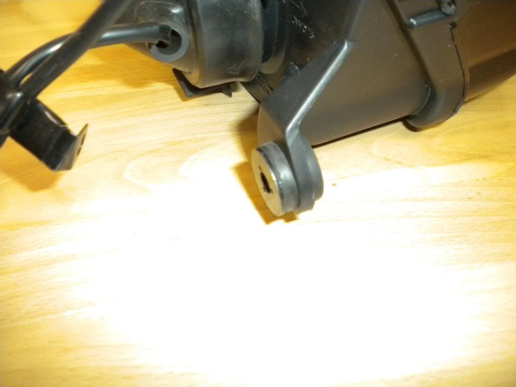

These are the mounting studs that got me thinking about this.
The only modification needed to make this work is to flip this spacer around to the front.

There was absolutely no wire modifications needed. The plugs are the same on both motorcycles. They are even color coded the same. Flipping the spacer around that I mentioned was the only thing I needed to do.
