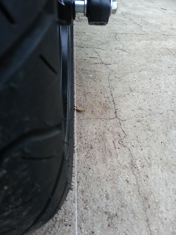

soooo, i was preparing the bike to put a 15t counter sprocket and for the hell of it i did wanna check how off are the hash-marks on the swingarm from factory to align the rear tire, i put it on a rear stand and used the string method, i double check that the front tire was strait and i was just kissing the rear tire edge and this is what i find...
just by looking at it there are not the same gap on both sides, i dont even had to take measurements lol, good thing i am gonna fix after i install that 15t, cheers

That doesn't look like an alignment issue. The back tire would be at an angle, wich it is not. It looks straight but offset. How do you fix that?
2,760 Posts
You sure its not the offset of the wheel itself.. The tire looks parallel to the sting in your pics..

lol that is a toe btw, i was confortable
back to the story, the back tire was not align to the front tire, that is what you see there on the string , one side have more space than the other side,
since i have to lose the rear axle to install the 15t, when i am tightening the rear axle back, i proceed to align the rear tire to the front via the string method. once it is align, then you adjust the slac with the adjusting screws, once that is done, torque the rear axle and done, i give you a pic but i dont have one now
