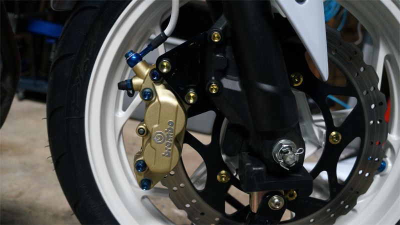

Not sure if you could re-use the stock 300 lines or aftermarket braided lines designed for the 300???

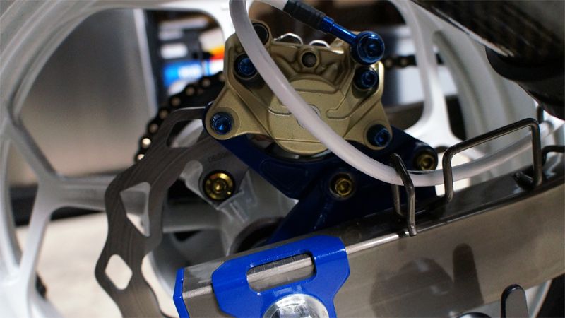

Not sure if anyone would know, but would these brakes work with the 300 ABS? Also does this improve or over improve the brakes. The rear caliper looks like a p32 or p34. Does the Ninja 300 need better brakes?

I think the rear brake is more for bling and to match the front.. I dont think I would mind at all having the upgrade up front... Stock is OK but stops nothing like a dual caliper bike, obviously..
I would do if it ti could find the calipers cheap enough..

I guess faster stopping is not exactly the best way to phrase it.. With more pad area comes more fraction.. So say with the stock brake lever you pull it 75% and and come to a stop.. With the bigger calipers you can pull it may 55% and stop at the same speed. So you have a power increase and can reach full lock easier.
Like you said your MAX stopping speed will not increase as it is most likely limited to wheel lock, but then again I have never emergency stopped this bike at 100+mph so maybe at that speed we cant lock the tire. Anyone care to try?? :D
Under worse case conditions this would be a upgrade. For a real world more its crazy overkill BUT for a obsessed modder such as myself, its just awesome haha
I have found the calipers for this online.. Whats crazy is the pre-packaged brake kit for the 250R is $750+. JUST for the front..
The calipers you need you can get in silver or gold (silver looks to be more costly than gold). They are $200-$250 for the front, and $100-$150 for the rear. Plus the above posted brackets so looking at less than $400 to $500 for a complete Brembo brake overhaul. Not sure how well these calipers work with the stock rotors, master cylinder or lines though....
