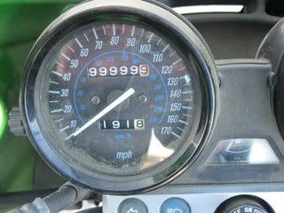

If 87 octane gas is unkind to engines, my old ZRX1200 R sure had a funny way of showing it.
