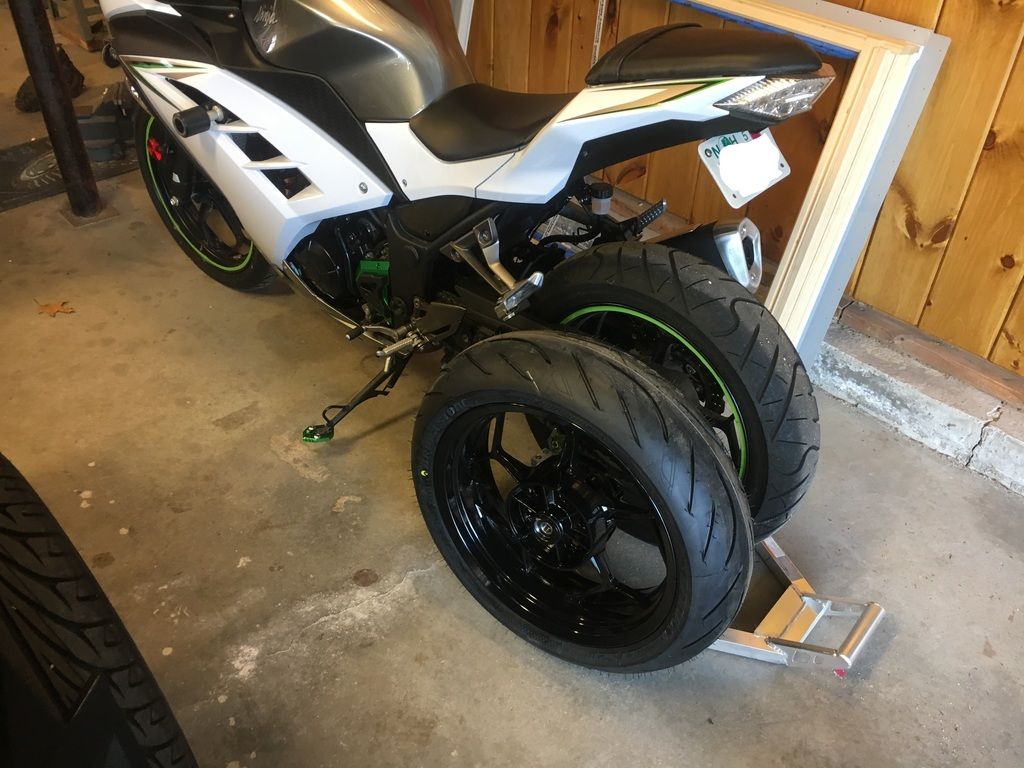

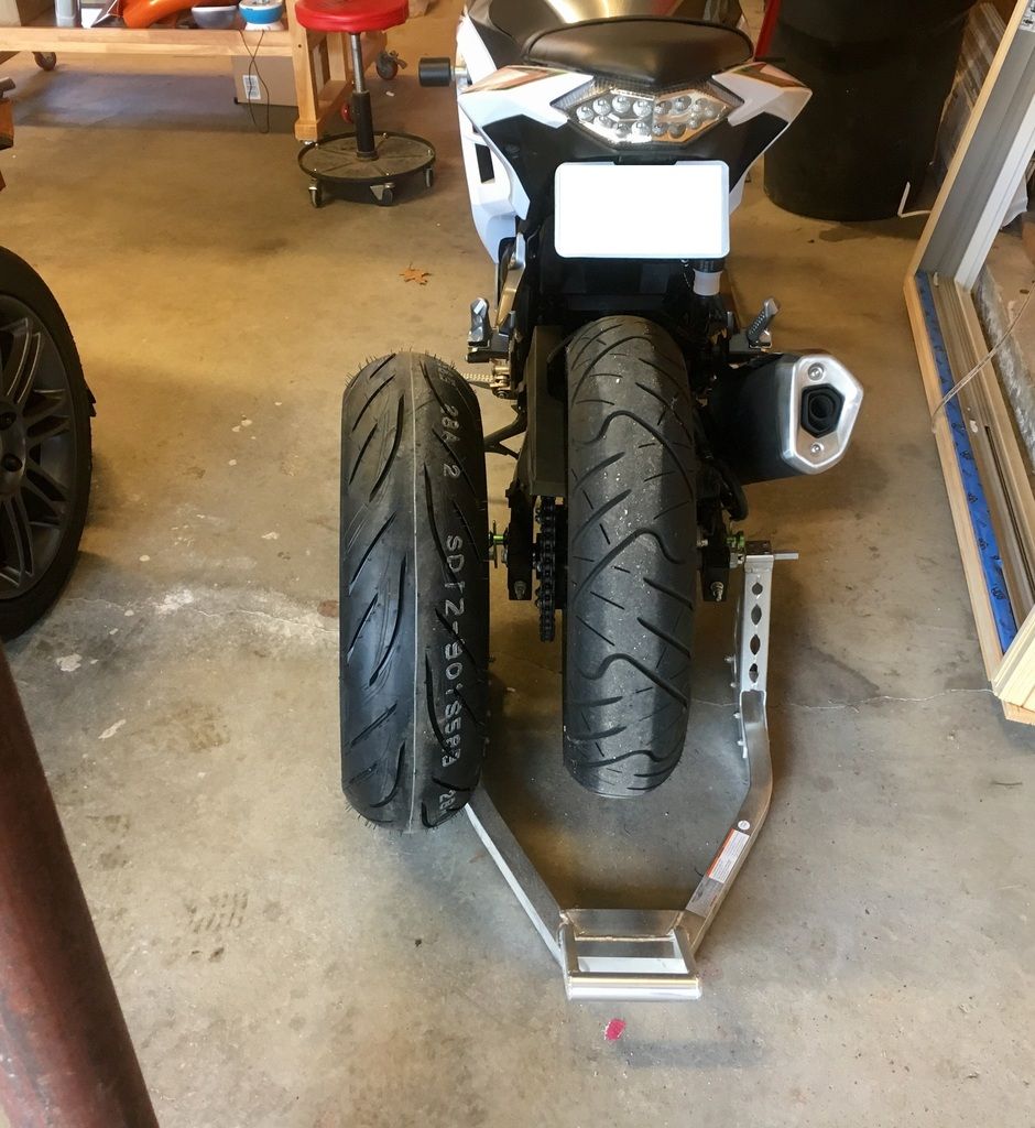

Got the tire mounted to the rim today. rim looks like its pretty great quality. no glaring issues from what i could tell. tech said it was a bear to get the tires bead to seat because of the powdercoat, but good to go. ill shoot a couple pics tonight and post them up when i get home with it next to the bike with the stock setup mounted. just the tire on the wheel looks killer. went with the Bridgestone Battleax Hypersport S21 motorcycle superstore got it to my door in a day for 120.99 shipped

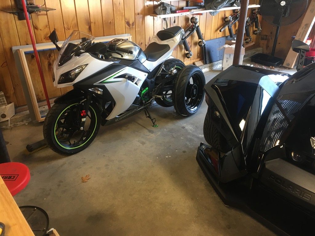

Awesome looks great bud. mine is still sitting on my workbench with the tire on it. waiting on some wheel stickers, and a 40t rear sprocket to show up.
did your tech put the washers between the rear sprocket and wheel?
