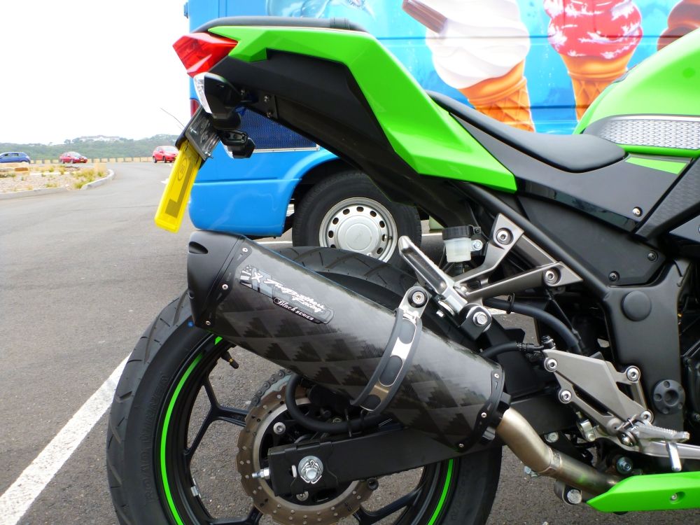

I'm also using the Mustard Bikes FE. Very easy set up, only need to remove the rear seat undo 4 bolts inside and snip wires. Mine was for stock indicators, a screw, brackets and some bad words got them off the stock fender. Then reverse process for fe kit (bad words included), bolt it on then solder.
You can see the screw and bracket in this pic.
yeah i see them. so you just cut all the wires under the pilion seat? im gonna probably figure it out once i have the seats off, want to try to do it as clean as possible.. but looks like im gonna have to splice anyway.

Yeah i need to tidy it up a bit when i get a chance. The wires are abit tricky as there is no play and i have fat fingers. When you have it apart you'll see where you want to go with it.
