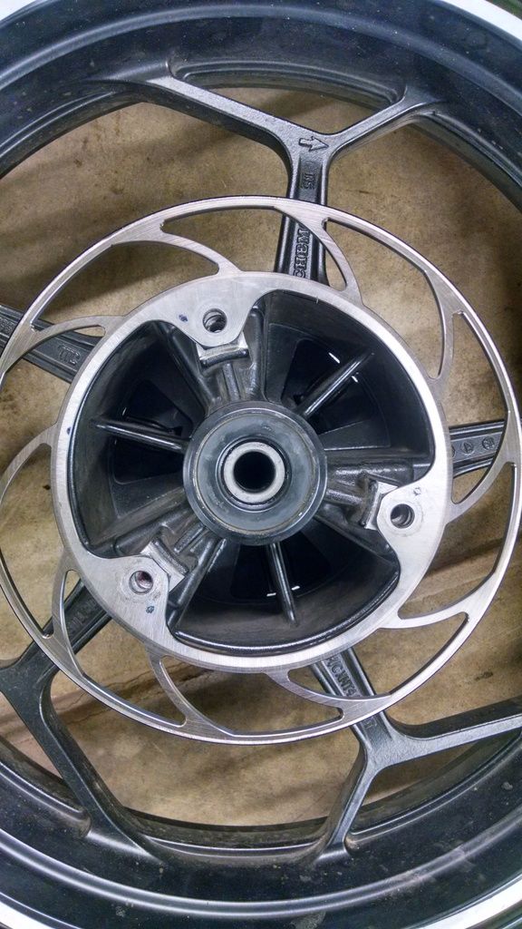

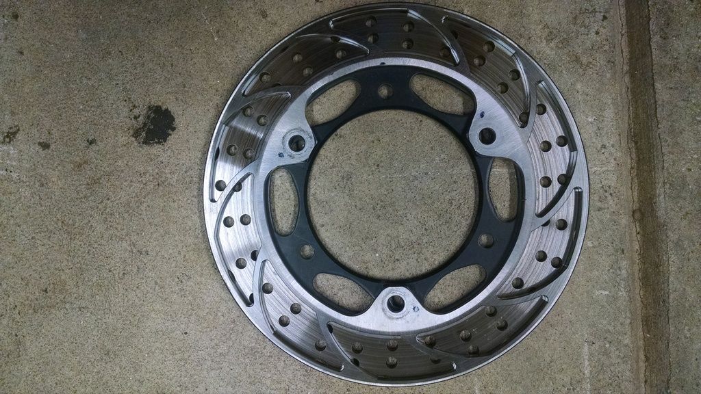

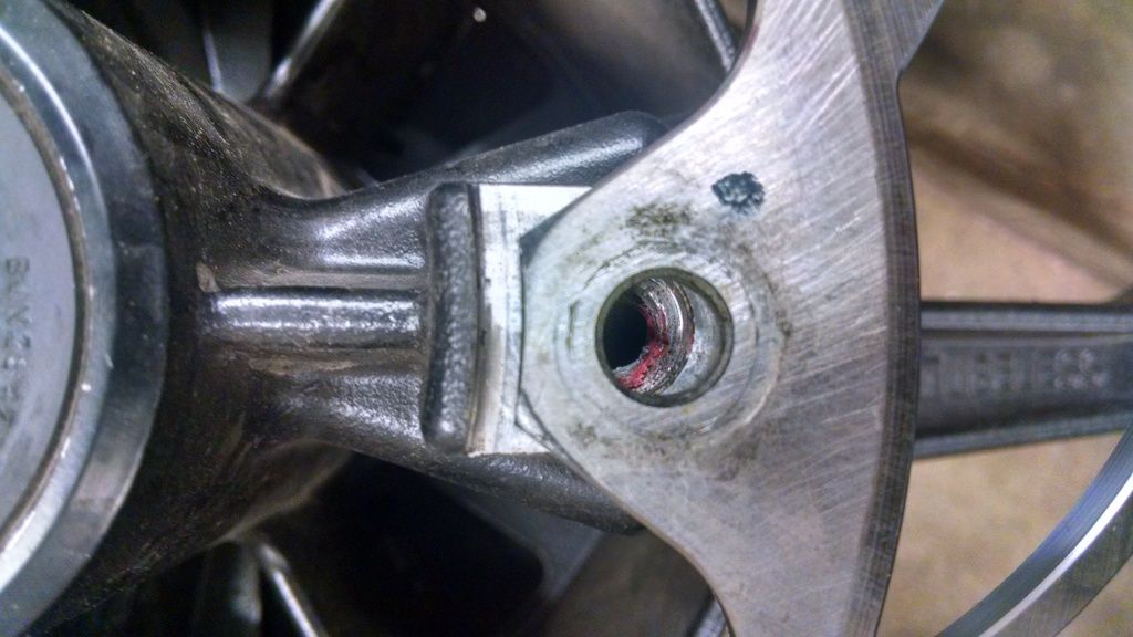

So bad news everyone...the R3 rotor doesn't fit. Boo It is pretty close, but the main issue is that the inner diameter is slightly larger and it doesn't seat on the wheel properly. Also, the mount holes don't line up by about 2 mm which isn't a huge deal and can be dealt with but is negated by the hub portion/inner diameter. You can see what I am talking about in the pictures.
So good news everyone... Today I had a friend look at both the stock N300 rotor and the cut R3 rotor, we took some measurements on both. We are going to attempt to write a program for his machines to cut the N300 rotors similar to the R3. It is going to cost a little chunk of money to get a prototype that I will test on my bike. If all works well and there aren't any problems, I plan on doing a small run of them. So we'll see.
Here is the cut rotor sitting on the N300 wheel. You can tell that the holes don't quite line up and you can see how the inner part of the rotor doesn't make contact with the wheel.
A little better detail of the rotor sitting on the wheel.
Here's a shot with the R3 cut rotor laid over the stock N300 rotor
Another non-issue is that the R3 brake pads are thicker from top to bottom so the N300 brake pad doesn't use the entire rotor. I don't think this is a problem at all because the pad still makes contact where it needs to but alas, it doesn't work anyway.
